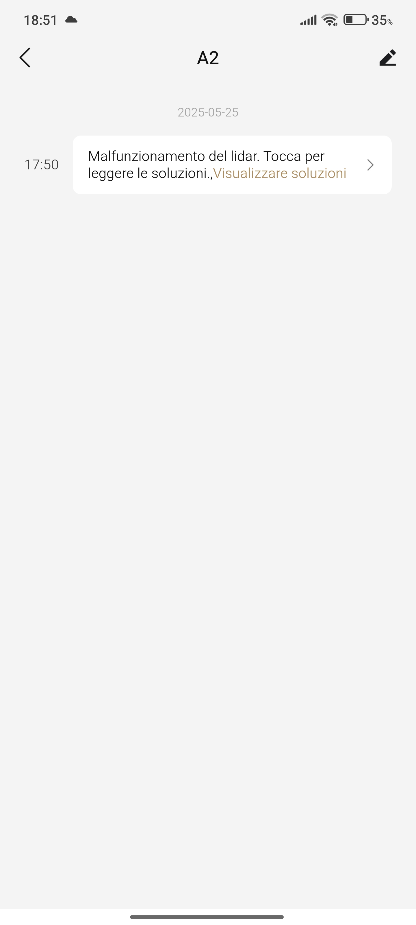

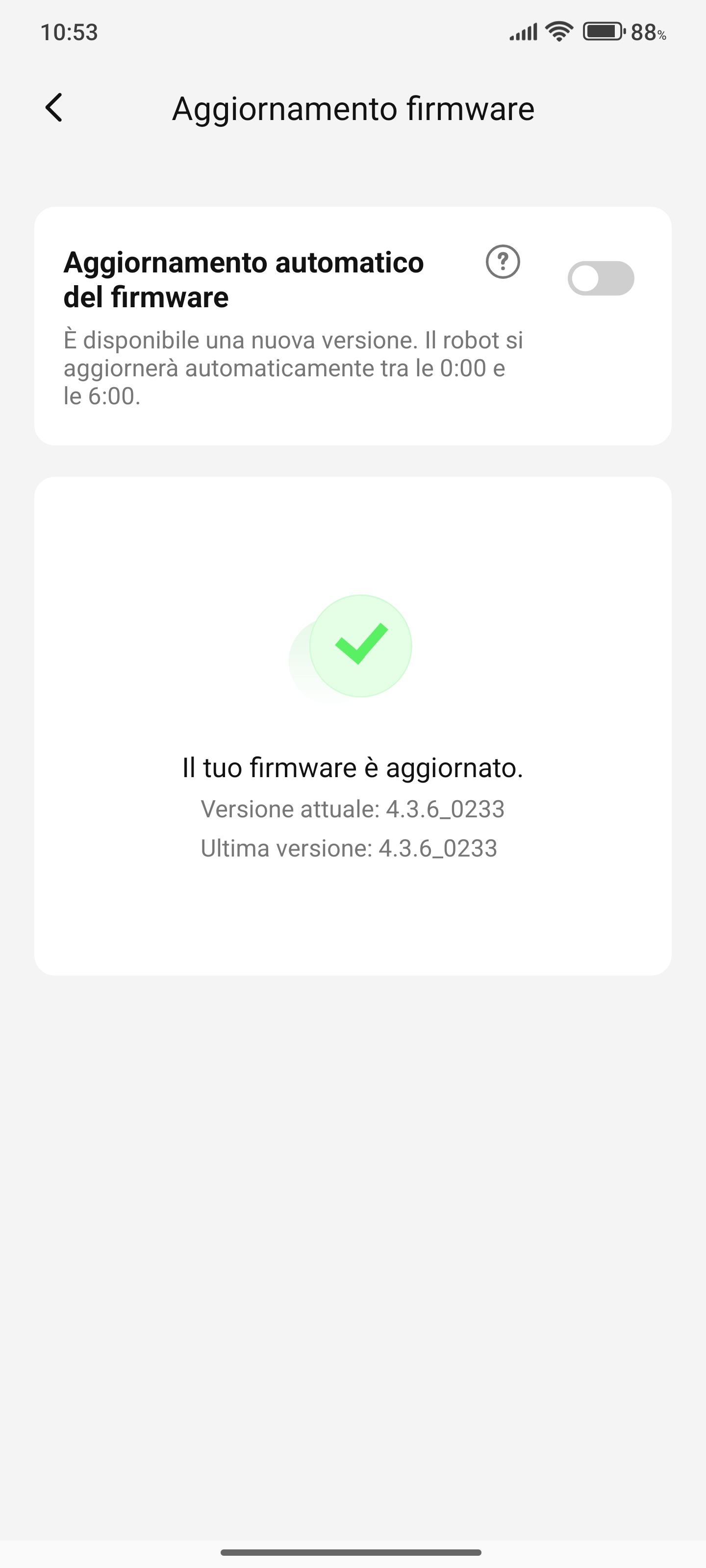

Good morning, after about two months of perfect use of the A2 lawn mower, yesterday the robot in the second daily program came out of the charging station communicating a malfunction of the Lidar, blocking. The lidar is perfectly clean and not scratched. I tried turning it off and on again, but nothing. I attempted a hard reset (erasing all maps and settings), but when I try to create a new map again, the calibration gets stuck at 60% presenting the same problem. I would like to point out that the morning work programme had worked. The firmware is 4.3.6_0233. I have already opened a support request with number 16095

Any problem with firmware ?
