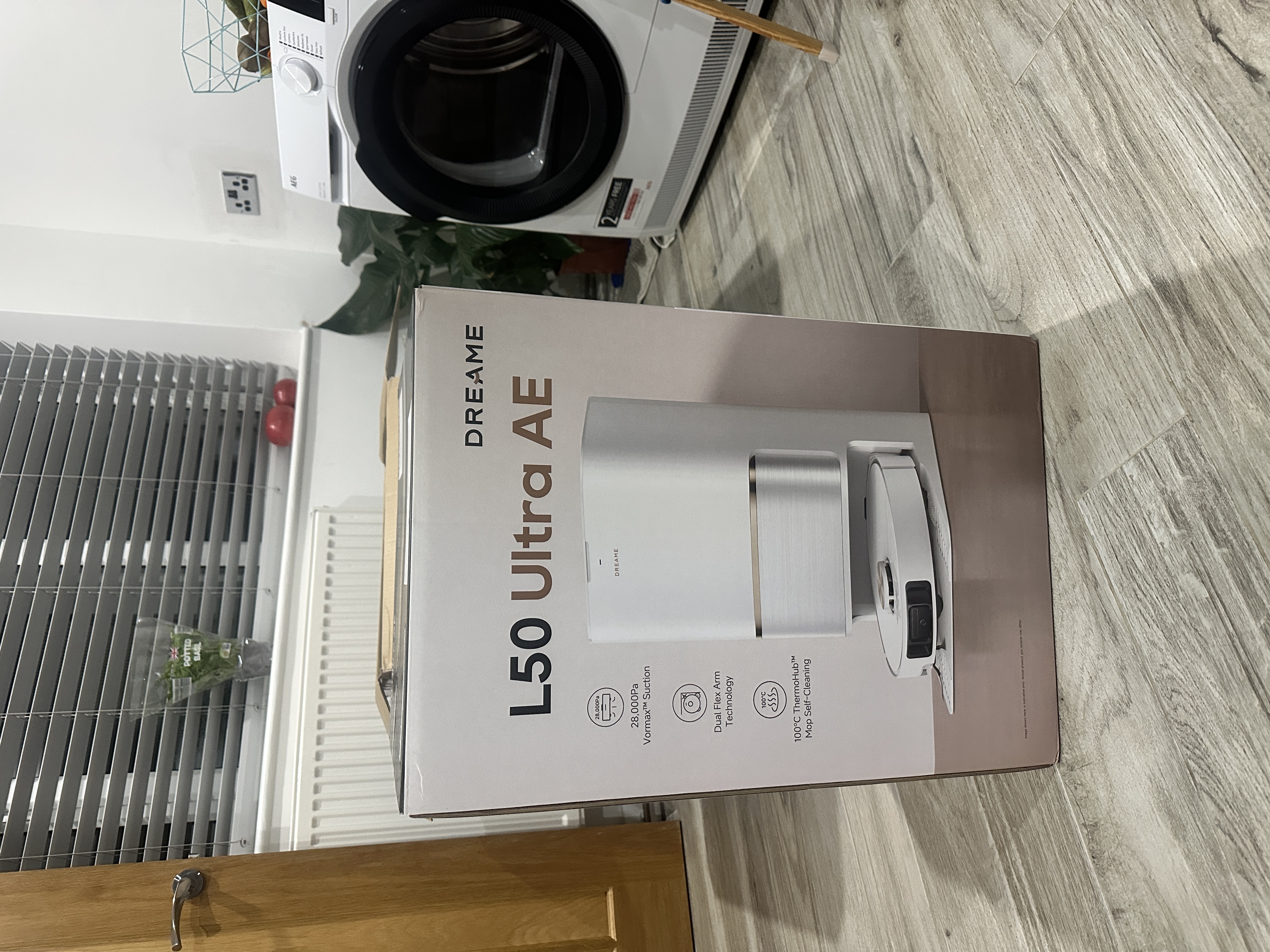

[L50 Pro Ultra] L50 ultra AE
Not sure why my model is not the header content but would like to ask if a floor detergent should be added to the main tank/clean water or only in the designated compartment. As I cannot feel or smell the detergent as it mops the floor.
L50 ultra AE
Thanks
