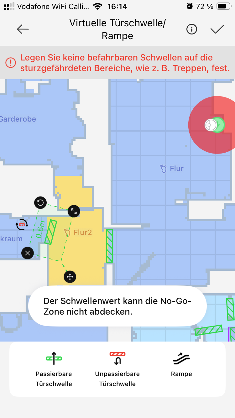

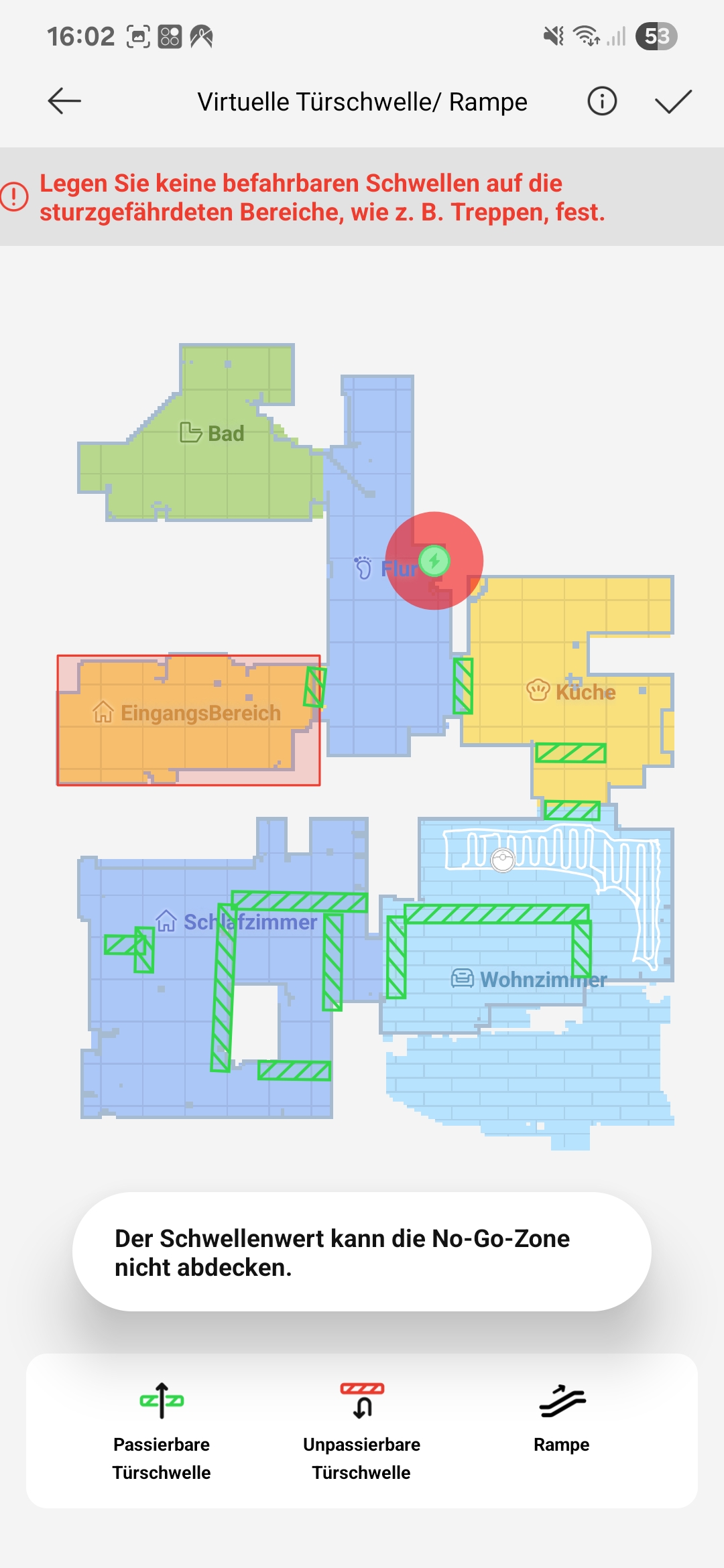

Currently, Shortcuts are tied to the active map. If I want to clean another floor, I have to dig through multiple menus just to switch maps. Only then do the Shortcuts for that floor appear. As soon as I switch back, they disappear again.
I think Shortcuts should be global. If I select a Shortcut for another floor, the robot should prepare itself at the dock (fill the water tank, configure the cleaning mode, etc.), leave the dock, ask me to move it to the correct floor, and automatically start cleaning once it's placed there.
Another thing I miss is that "Vacuum then Mop" isn't available on secondary floors. Since the robot starts at the dock anyway, it should be able to prepare for this before being moved.
Finally, what's the status of Matter support? It's been advertised for a long time, but I can't find any Matter settings in the app, the QR code doesn't work, and I haven't seen anyone successfully connect an X50 Ultra using Matter.
Does anyone else feel the same, or have I missed something?
