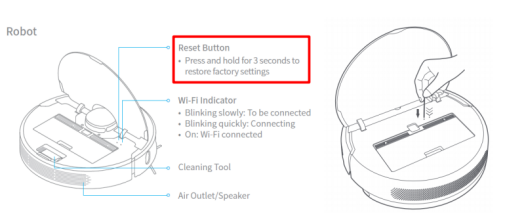

3. Please reset the robot and try again. Open the top cover and press the reset button with a tool for 3 seconds until you hear the voice prompt "Start restoring factory settings" (see the attached picture). Then restart the robot and try again.
*Please note: After resetting the robot, the cleaning data will be cleared and the cleaning settings will be restored to factory settings.
