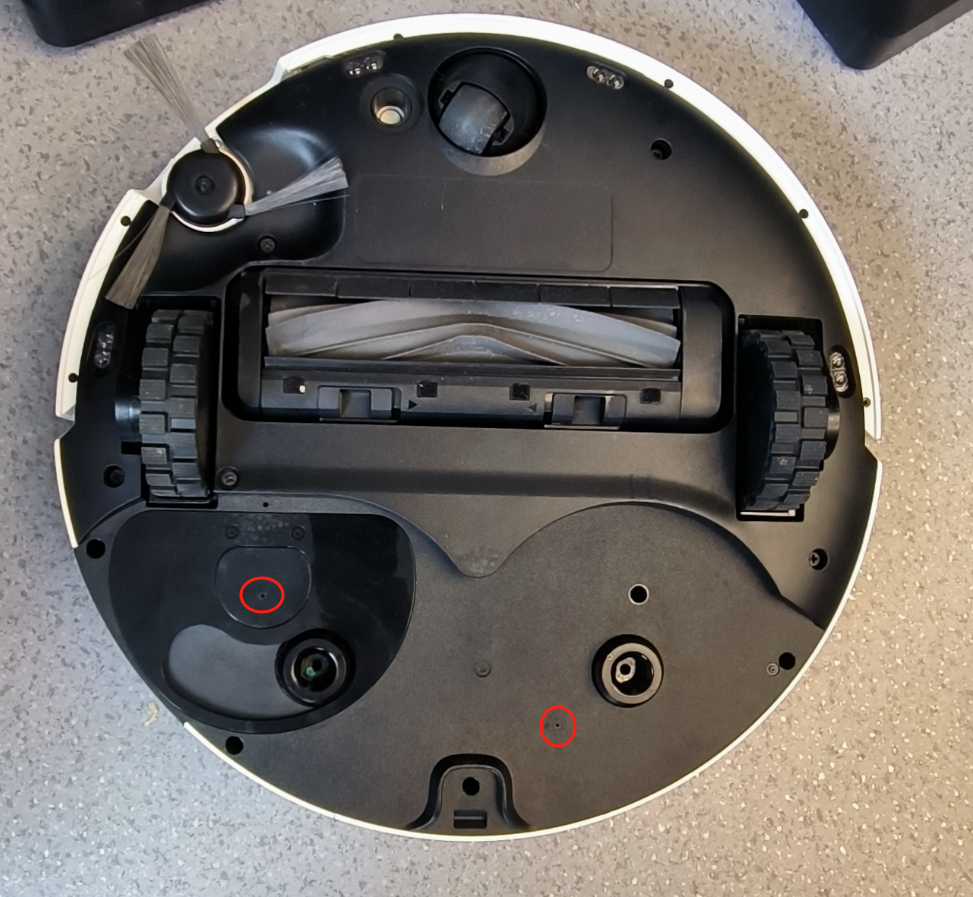

Hello, this situation may be caused by the blockage of the pipe inside the robot, which makes the small water tank unable to wet the mop.
After washing the mop pad, remove the mop pad from the mop pad holder, install only the holder on the robot, start the mopping task from the base station, wait for 5 minutes, and check if there are water drops on the ground.
If no water flows out in the above test, remove the mop pad holder and poke the water outlet at the bottom of the robot with a wire, toothpick or other object (please refer to the attached picture). Check whether the mopping problem is solved.

I did not do this test yet, but i see the water flow on de mops while mopping for +- 3-4m², aftershave that there is nog more water flowing to the mops.
AH944094 Thread Starter
Dit the test yesterday, thee was a little water on the floor at some places where the vacuume passed. The water use was set to max.
