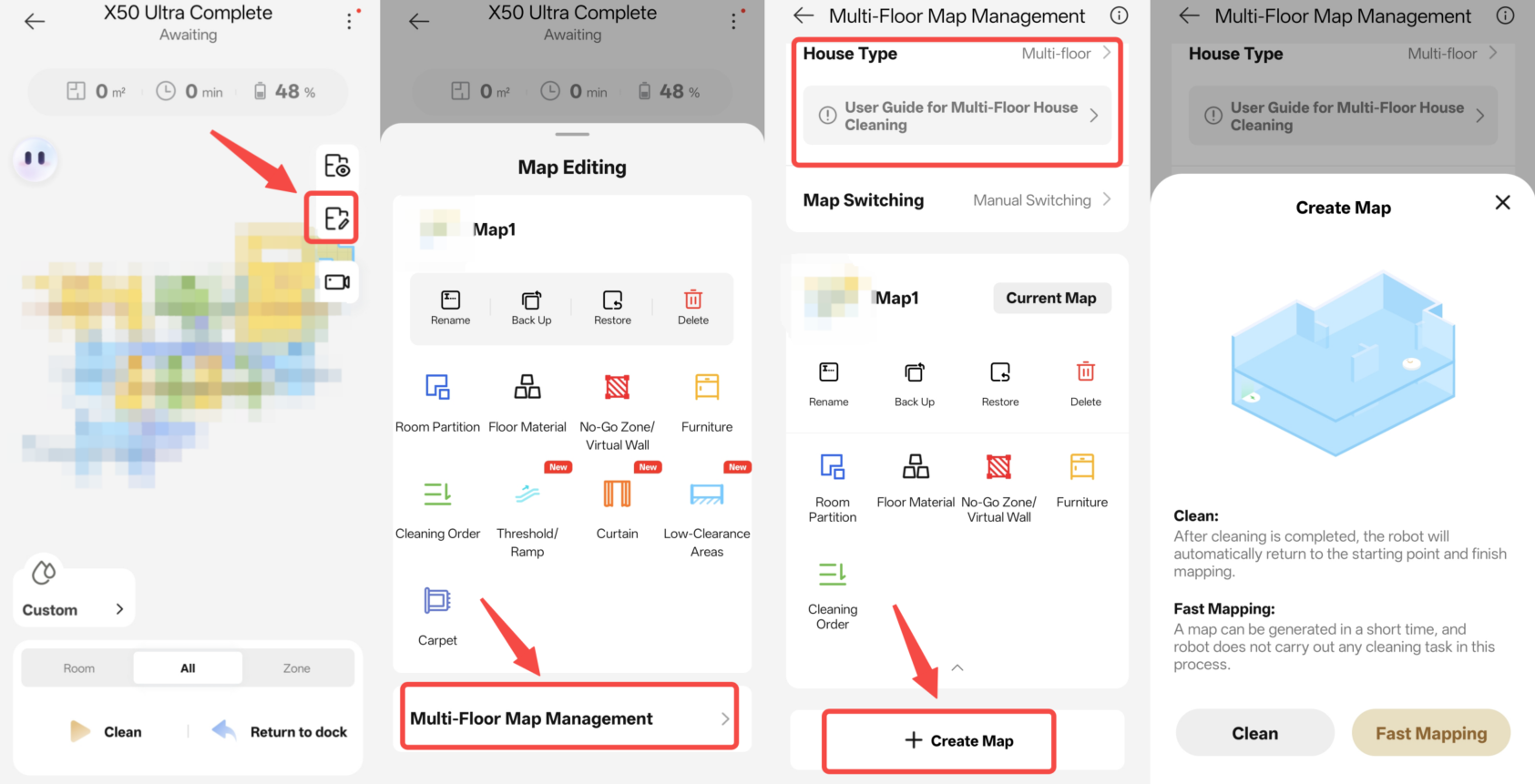

Thank you for contacting Dreame.
If you would like to use the robot vacuum on different floors, you can use the Multi-Floor Map feature.
Creating Multi-Floor Maps
1. When creating the first map, the robot should start from the charging dock. Once the mapping process is completed and the robot returns to the dock, the first map will be saved automatically.
2. After selecting Multi-Floor Mode, the robot will return to its starting position once it finishes mapping or cleaning on a floor without a charging dock.
3. When using Multi-Floor Mode, we recommend enabling the Smart Recognition feature to automatically switch between maps.
Note: After a map has been saved, if you notice map distortion, abnormal routes, or any unusual cleaning behavior, please delete the map and create a new one by remapping the area.
Cleaning on Multiple Floors
1. Move the robot to the target floor where there is no charging dock, then start the cleaning task through the app or by pressing the button on the robot.
2. During mopping, you can manually move the robot back to the charging dock if you would like it to wash the mop pads.
3. Once all cleaning tasks are completed, the robot will return to its starting position. You can then manually place it back on the charging dock for charging.

Reference image
