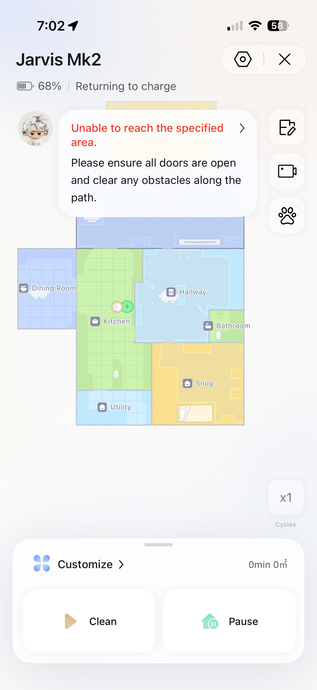

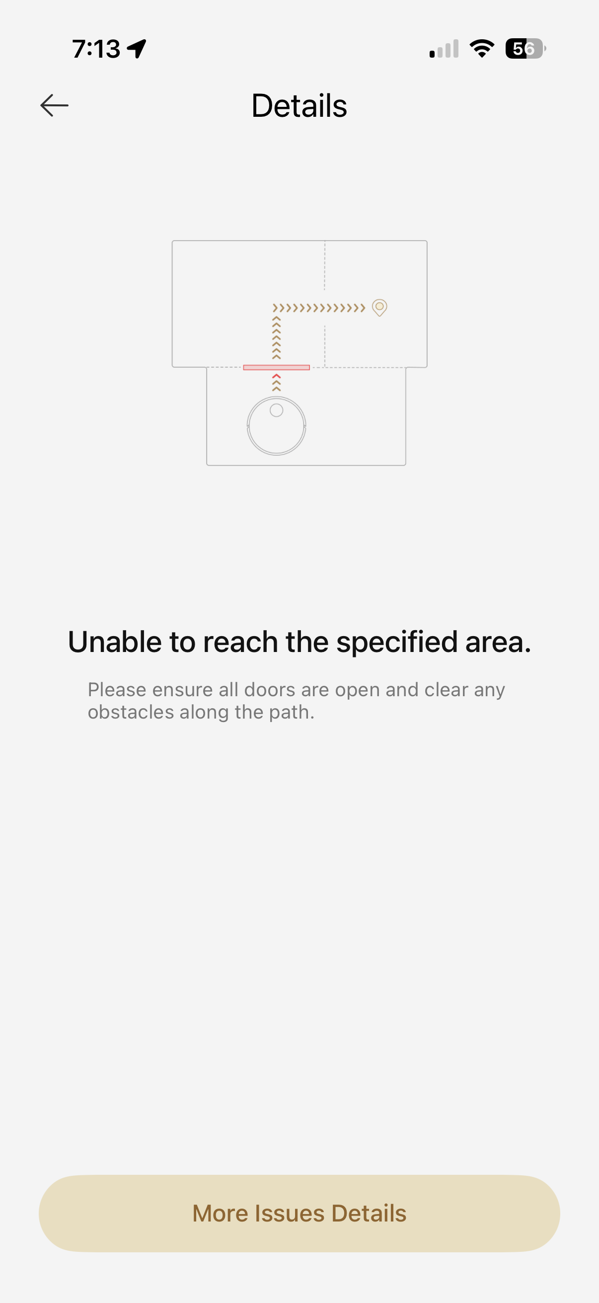

This arrived this week and I set it up last night. Mapped easily enough but when ever I set it to clean rooms it heads out of the dock about 1m, vacuum starts up and then it comes up with an error message and returns to the dock. I’ve done every suggested fix, there is nothing blocking the route and even reset and started again but the same problem comes up. Hoping Dreame will respond quickly to my email.

We sincerely apologize for the inconvenience. Based on the image you provided, the map appears to have recognition and mapping abnormalities.
We recommend repositioning the charging dock and creating a new map.
