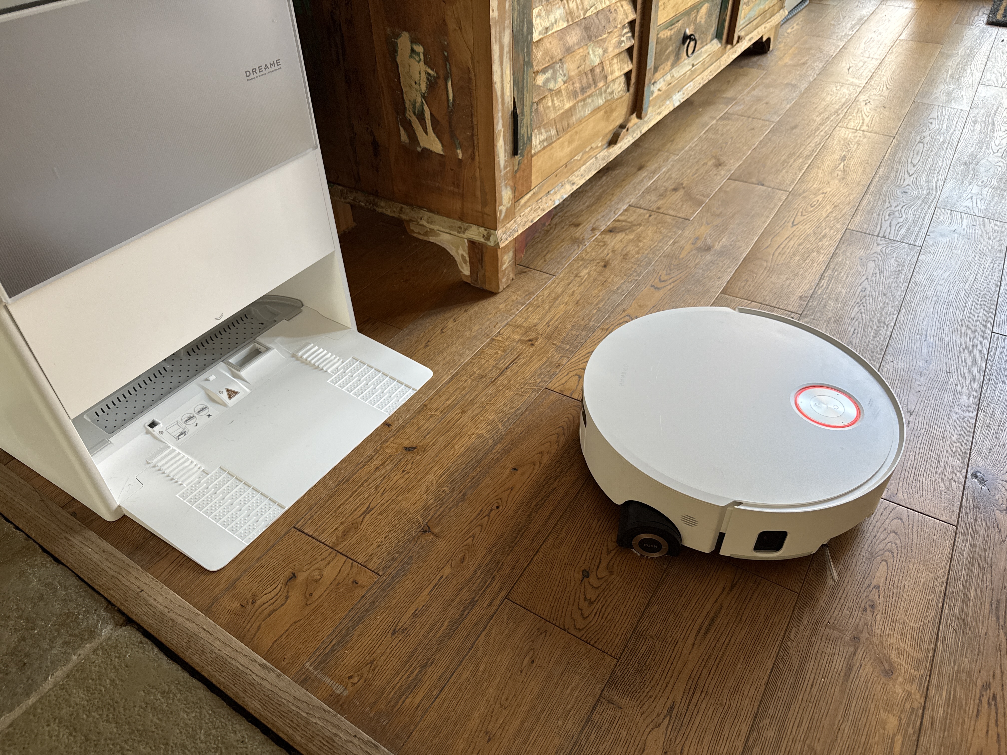

Help! I’ve had my Dreams Aqua 10 roller for a day but after starting a mop it stopped and said ‘roller mop error’. I’ve followed all instructions, and there is no debris anywhere, but it still won’t retract. It will try and find its location again (rotate around) but will then close down again with the same error. The roller is physically put to one side. I’ve even swapped over the roller to the spare one but that makes no difference.
Any ideas of what else to try?
