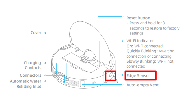

Regarding the edge cleaning issue, please try the following steps:
1. Clean the edge sensor located on the right side of the robot using a soft, dry cloth. Also make sure that the sensor is not blocked by any dirt, debris, or other objects.
2. Try disabling Collision-Avoidance Mode and check whether the edge cleaning performance improves:
Three dots (top right) → Floor Cleaning Settings → Collision-Avoidance Mode
3. We also recommend setting the Mop Extend Frequency to "High Frequency" to improve edge coverage.
Regarding the sofa being recognized as a wall, we recommend running a full-house cleaning task in CleanGenius mode and checking whether the map updates correctly afterward. If the map does not update and the sofa continues to be identified incorrectly, it may be necessary to create a new map.
We hope these suggestions help.
