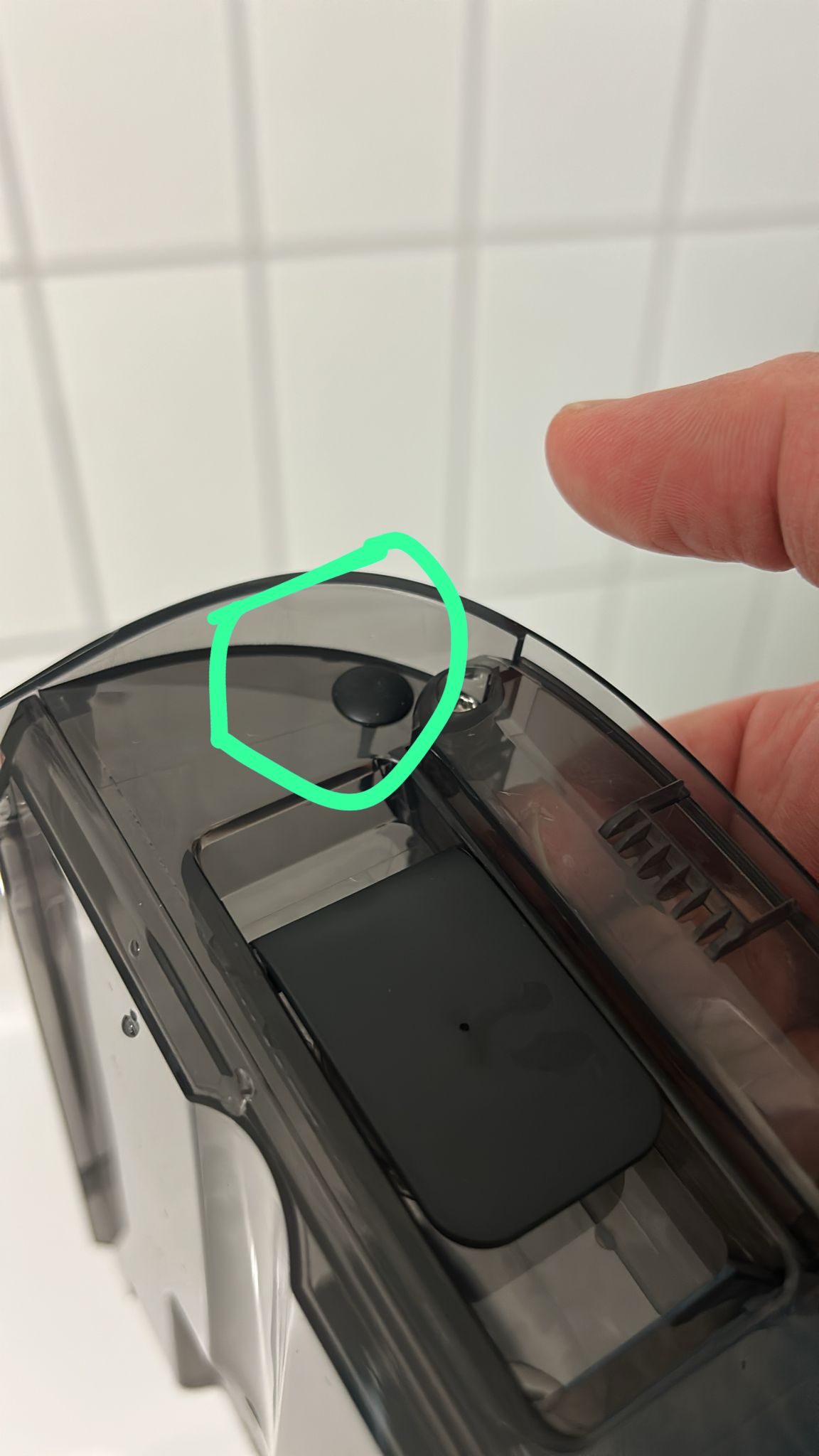

3 questions below. Can you guys help me please.
1. How does the Automatic Cleaning Solution dosing work? Does it dose on the brush directly or into the clean water tank?
2. I do not see any inlet into the clean water except this rubbery thing on top (see photo). Does it need to removed? I do not see any instruction for this.
3. I live in Switzerland and cannot find a shop that sells the cleaning solution and replacement brush and filter...Can you recommend?
Thanks!

2. Regarding the rubber-like object on the top:
You do not need to remove it. The black square in the depression next to it can be opened. After opening, you can add clean water.
