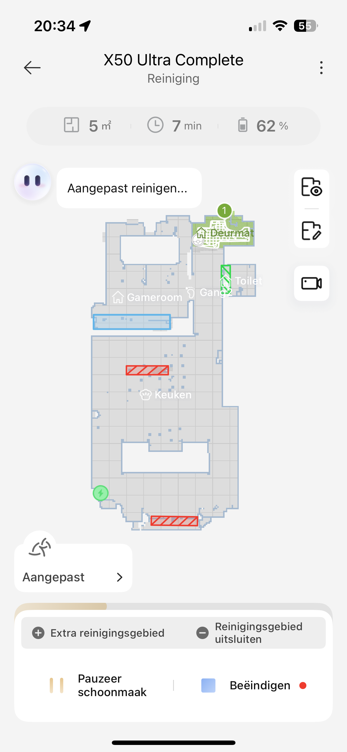

My dreame puts the docking station in my bathroom but it isn’t there. So now it doesn’t clean that spot. This happens every time I put it in the bathroom and I don’t know why it does this. Does anyone have a clue?
I choose to clean the bathroom bij selecting the room/floor than start cleaning press pause so I can take it to the bathroom. The bathroom floor map didn’t have the docking station in it but when I start cleaning the dreame just puts it in

Hello, can you update a complete map screenshot and mark the real base station locations and fake base station locations on the map?

The location of the real base station isn’t on that floor. In the picture is the spot of the real base station. The fake base station is in the first picture

This is what I already did. I created a room map and the vacuum had cleaned it before without a problem and not “seeing” a docking station and when I wanted to clean the room again it put a docking station in the room.
Could it be that when I move the vacuum it had seen the docking station on the other floor and kept that picture and when it scanned the bathroom put the picture of the docking station in the room?
