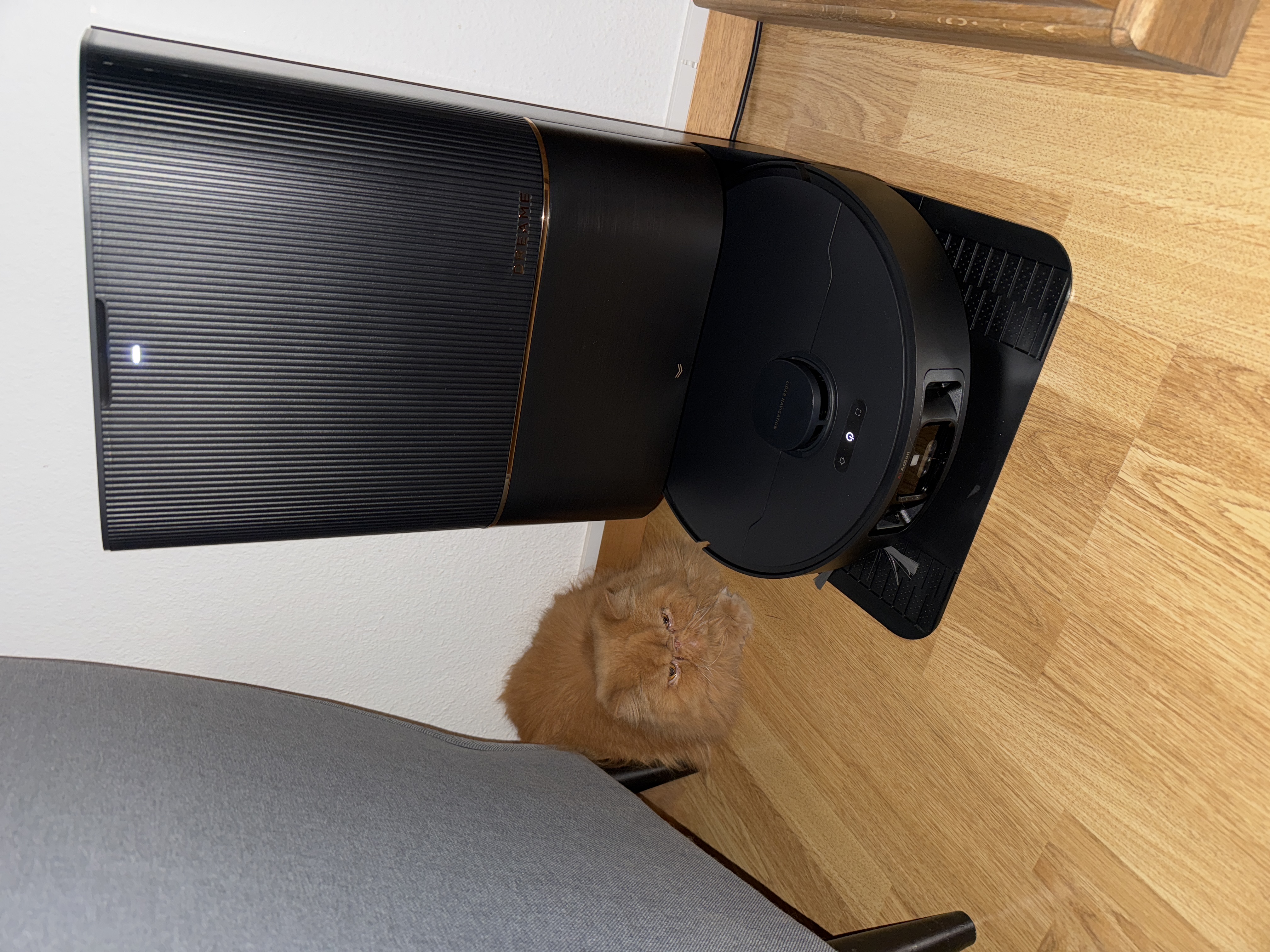

When I try to connect via QR Code, the robot doesn't connect. It says "l'appareil n'est pas lancé" in French. When I try to connect manually, it works until the end of the process but there's an error message at the end saying "pas d'appareil connecté" and m'y dashboard remains empty.
Can you help me ?
