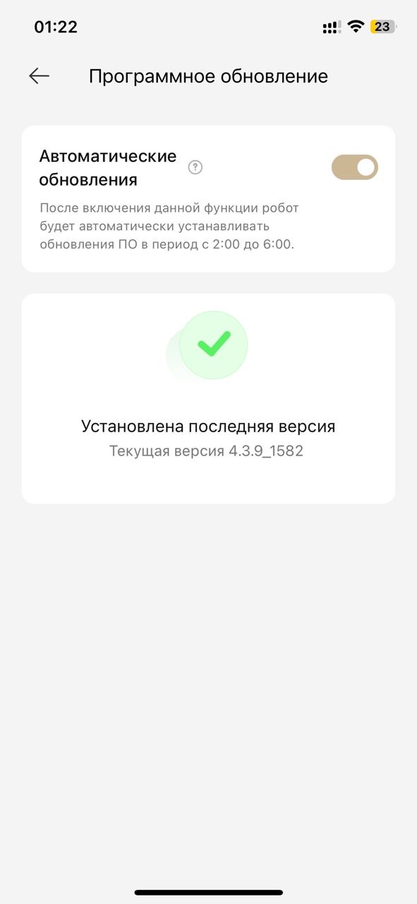

Hello. Tell me why the camera on the x50ultra doesn't work
Это последняя версия обновления
Still giving you trouble after the update? If the floor types keep reverting, I'd do a factory reset and let it remap from scratch.
